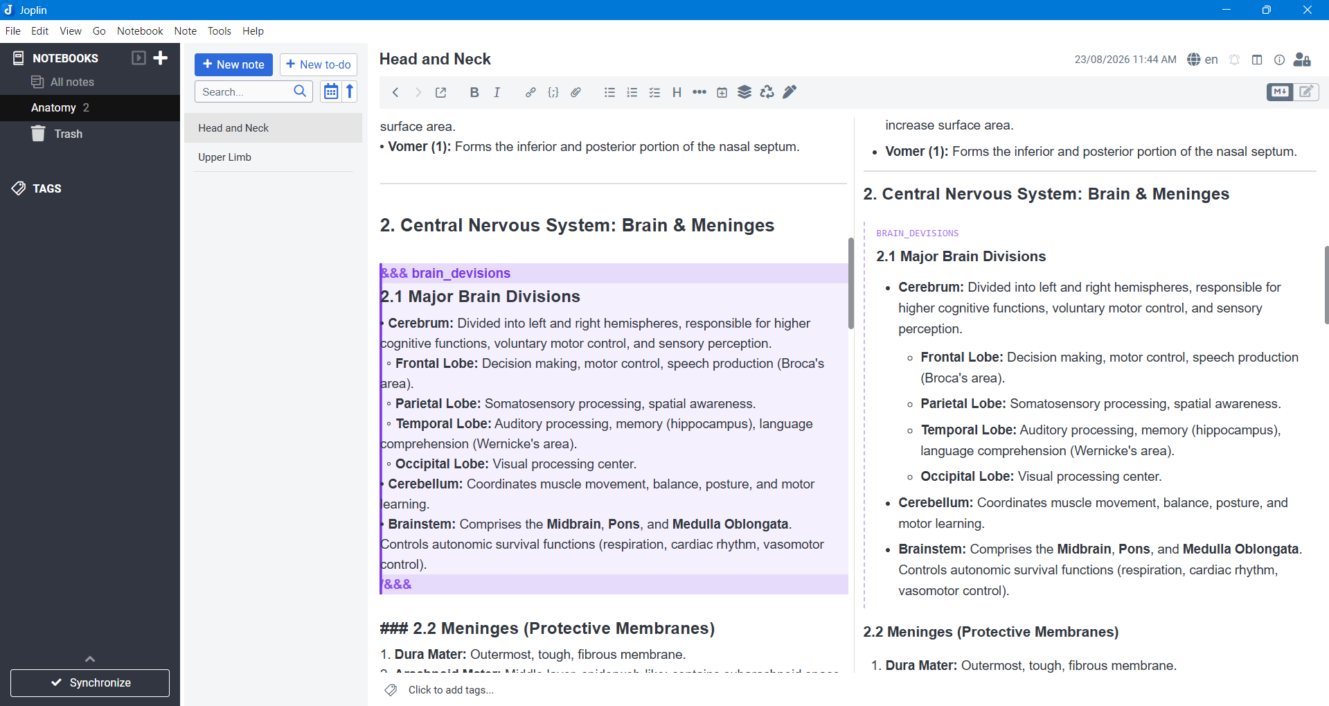

Marking a section as shareable
Mark the part of a note other notes may reuse. It stays ordinary markdown, and the viewer marks it out quietly.

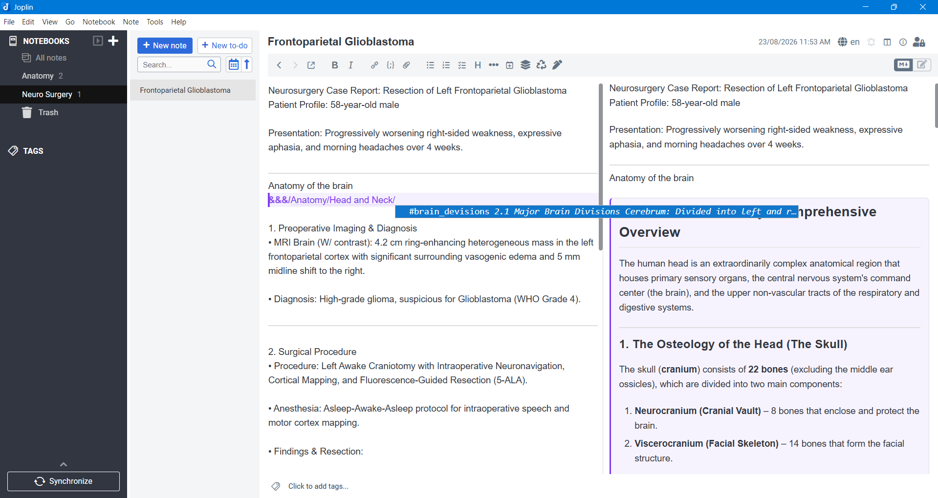

Picking a section from the drop-down
Type &&&/ and the drop-down walks notebooks, then notes, then the sections of the note you landed on - with a preview of each.

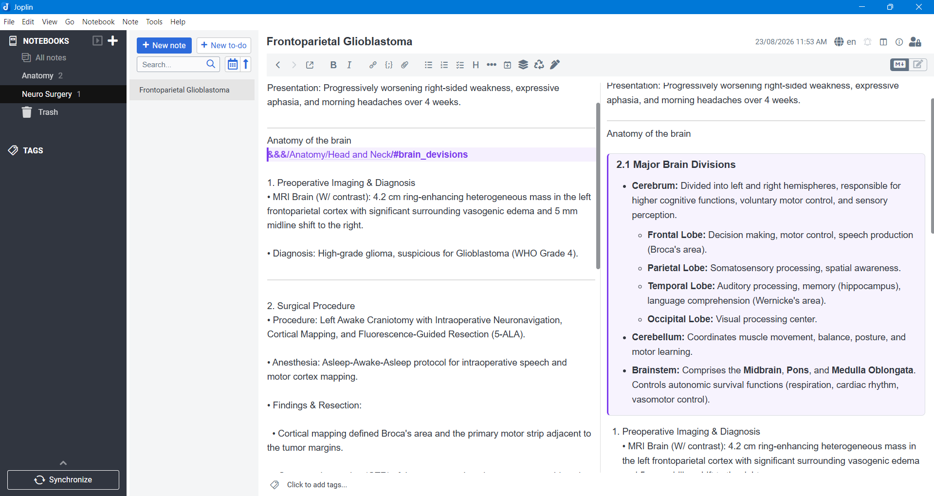

The section reused in another note
One reference line in a note in another notebook, and the section is drawn in place - headings, lists and all, exactly as in the note it came from.
