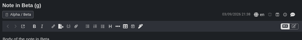

Own row below the title (default)
The notebook chip on its own row below the note title

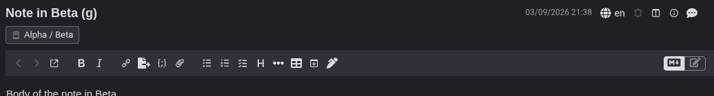

Own row below the title, with the title-row icons moved down
The title gets the full width; the date and the note-toolbar icons drop onto the chip's row.
The compact variant

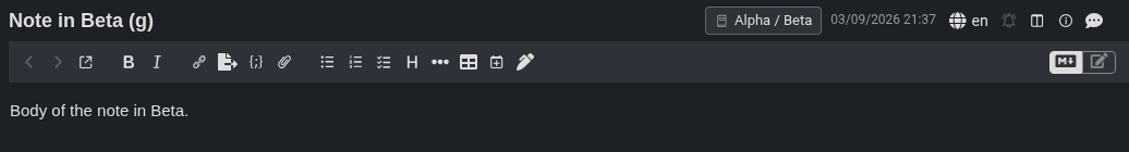

Right of the title
The chip inline, to the right of the note title

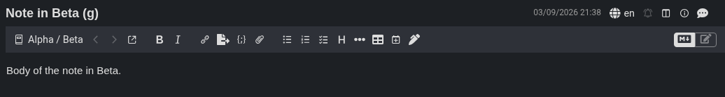

First item of the editor toolbar
The chip as the first item of the editor toolbar
